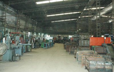

Perfect INC. specializes in manufacturing welded articles through methods such as stamping, forging, machining, and tooling. Besides exporting its construction equipment to customers in Canada, Europe, Germany, and the USA, the manufacturer also supplies its components to multinational companies with subsidiaries in India. Perfect INC. is also the parent company to Perfect Group and Perfect Forgings, and the three corporations are located in Ludhiana, India.

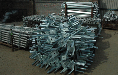

Quality construction components including scaffolding, pillars, and structures are manufactured in-house.
The company prides itself on manufacturing high-quality construction equipment such as scaffolding, pillars, and structures. Since its establishment in 2005, Perfect INC. has meticulously monitored its measurement, calibration, and inspection processes. Each construction component is carefully measured by employees before production and after final-inspection stages using vernier calipers, height gauges, and fixed coordinate measuring machines (CMMs). In its production facility, Perfect INC. manufactures equipment of varying sizes - small tools of 100 mm and larger pieces of up to 3 m - with a maximum weight of 15kg. These tools are then combined to create different construction assemblies.

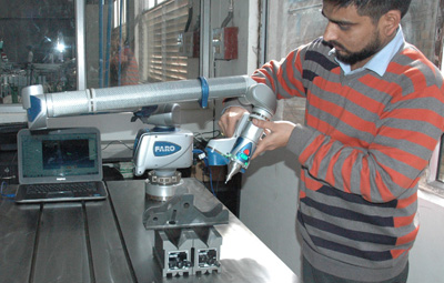

An employee demonstrates how the FARO Edge ScanArm® HD is used in product inspections.

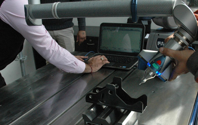

The ScanArm features unparalleled non-contact measurement capabilities.
The construction equipment manufacturer got in touch with FARO and clarified its requirements for measurements and applications. After assessing Perfect INC.’s needs, FARO introduced its nine-feet FARO Edge ScanArm HD – an advanced metrology solution that integrates the functions of the FaroArm® with a hand-held laser scanner.
The ScanArm is a seven-axis measurement solution that offers maximum data handling, highest accuracy, and optimum efficiency for users. Adding unparalleled non-contact measurement capabilities to the FaroArm, the ScanArm is able to scan even the most complex shape, and is ideal for measuring the different sizes of Perfect INC.’s construction equipment.

Since acquiring the ScanArm, Perfect INC. regularly utilizes the device to calibrate and inspect the construction equipment and tools that are manufactured in-house. The ScanArm is now a key component of an important monitoring system at Perfect INC., and is used weekly to detect errors before and after the production stage. With the ScanArm stationed on the shop floor, the Perfect INC. team also achieved unprecented savings in time and labor, as components do not have to be physically moved to a separate measurement room with controlled temperatures for accurate measurements to be taken.
Perfect INC. can now generate calibration data reports easily, without the hassle of filing manual reports. The ScanArm also delivers reliable, repeatable, and reproducible measurement data with every scan. Before the FARO ScanArm, Perfect INC. had trouble obtaining data with similar reliability and consistency using other metrology solutions.
