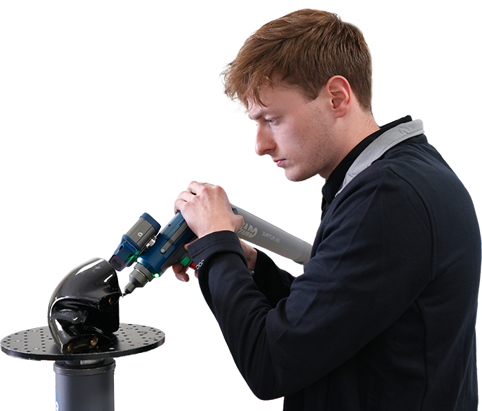

Probe & Scan in One
Contact probing or non-contact scanning in a single device.

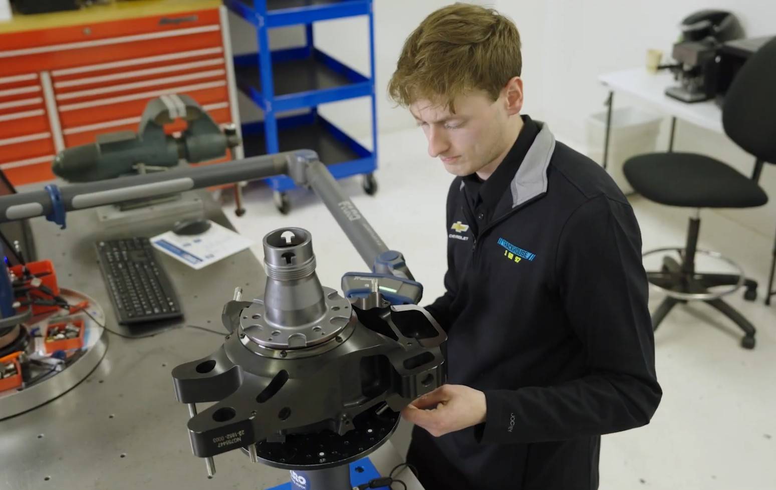

Quality Control & Inspection
Verify dimensional accuracy, identify deviations from nominal CAD data during first-article, in-process, and incoming parts inspection.
Keep production machinery calibrated and aligned. Verify dimensional accuracy of tooling and parts on the shop floor.
