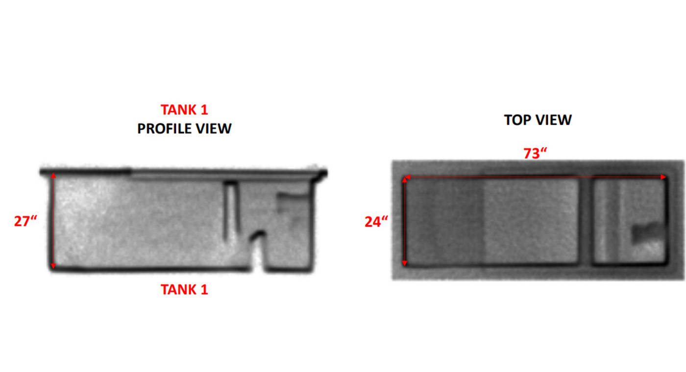

CAD drawing and measurements of an oil tank
Scanning Environmental Features to Work out Contour Lines
The Kansas Adjutant General's Department has tanks that contain hazardous material which they need to track carefully. Using the ZEB Horizon, they scan exterior environmental factors to figure out contour lines within a complex. This helps them work out where any spillages of hazardous material would go, should they occur.

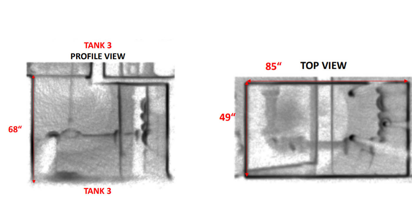

Collecting Accurate Measurements of Underground Oil Tanks
The ZEB Horizon's time-saving and accurate scans have proven to be a cost-effective method of data capture. For example, scans of underground empty oil storage tanks showed that the Kansas Adjutant General's Department had been overestimating the tank's collection capacity, leading to an adjustment of the servicing contract and ultimately a cost saving.
