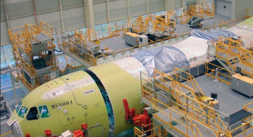

Final Assembly of Airbus 400M
In my last blog post, I talked about measurement assisted assembly (MAA). Measurement Assisted Assembly is a key operation for the reduction of time in aerospace assembly, which can account for as much as 40% of aircraft manufacturing costs. In this post I will present an interesting example of MAA: Assembly of aircraft through the guidance of measurement devices.

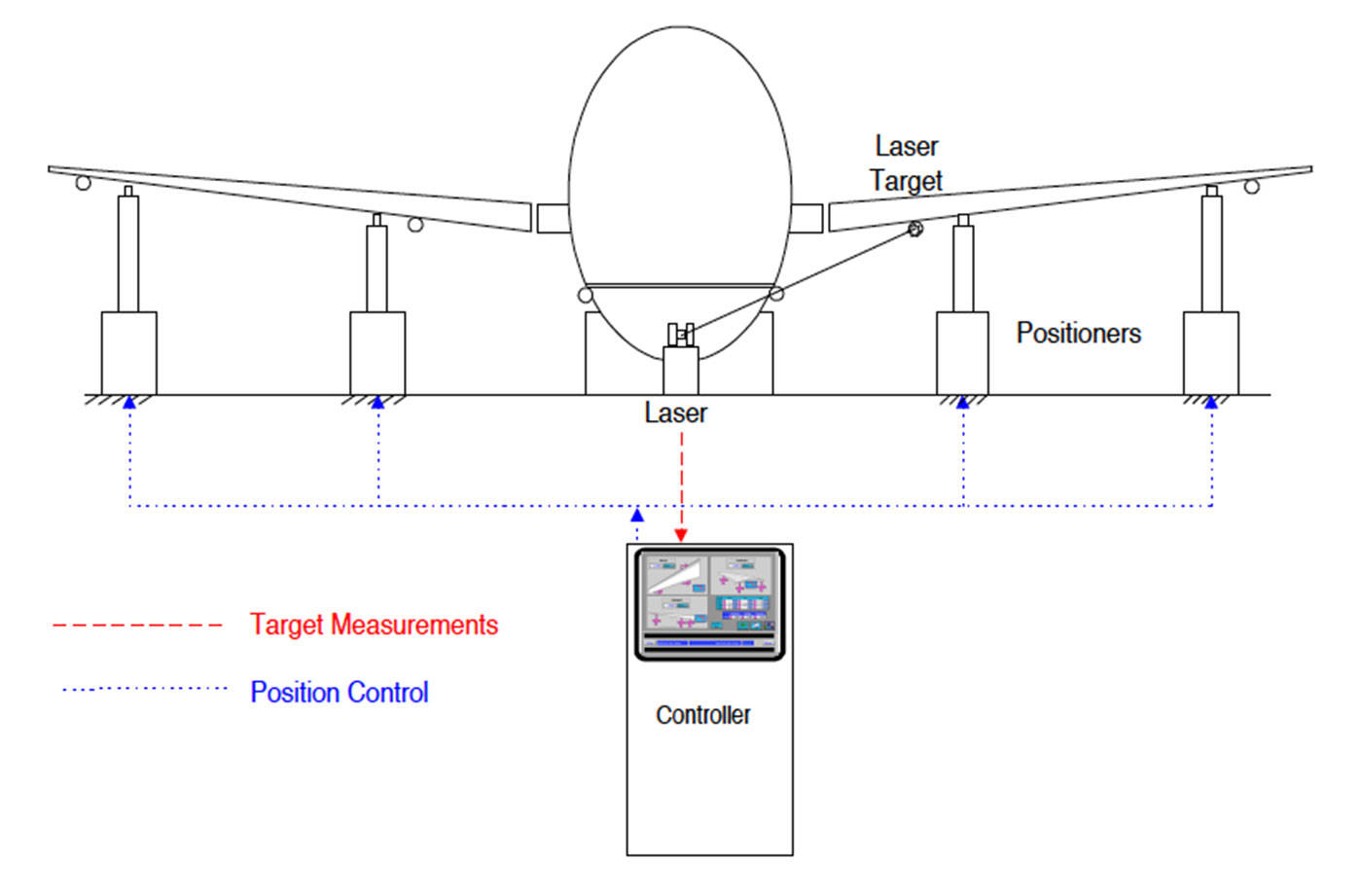

AINT Measurement Assisted Assembly Method: Measure, Align and Position with Motorized Positioners

Diagram of AINT measurement assisted assembly method: Measure, Align and Position with Motorized Positioners
An impressive example of this method is offered by the Advanced Integration Technology (AINT) company. This company uses similar methodologies in both the Boeing 787 Dreamliner and F35 Joint Strike Fighter assembly projects.
A typical automobile is composed of approximately 20,000 components, while a Boeing 777 is composed of 4 million.
In this case, the Measurement Assisted Assembly System is comprised of three main components:
  1. Measurement system: Laser tracker
  2. Controller: Software that provides feedback to positioners
  3. Positioners
The MAA system designed by AINT can be summarized as follows:
  1. Aircraft structure is placed on motorized positioners.
  2. A laser tracker measures the position of laser targets placed in different places on the aerostructures.
  3. The laser tracker provides feedback on the real position of the targets to the technician through a GUI interface.
  4. The technician aligns the aircraft structure by maneuvering the motorized positioners with the help of a joystick.

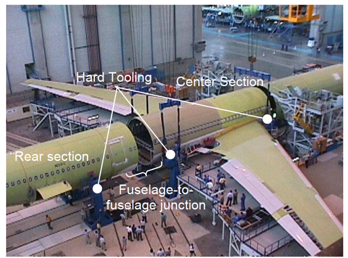

AIRBUS Measurement Assisted Assembly Method: Measure, Align and Set the Jigs Accordingly
Airbus Assembly
AIRBUS Method: Measure, Align and Set the Jigs Accordingly
In the case of Airbus, a fuselage assembly is performed by using Measurement Assisted Assembly in their final assembly line in Toulouse. This method uses:
  1. A laser tracker system
  2. An optimization software
Airbus fuselage assembly process flowchart

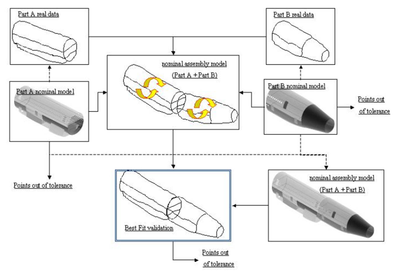

First, the laser tracker measures the real positions of the assembly points on the fuselage sections. Next, the software calculates the optimum positions for alignment of the fuselage sections. The jig positions are then set up accordingly by technicians. This method does not use motorized positioners for the final fixture adjustment in contrast to the assembly method used by AINT in the previous example.
