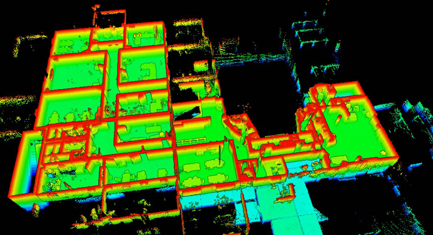

Many of the areas Shamrock+ captures are large exteriors and the 100m range of the ZEB Horizon makes it an ideal solution. The team carried out an architectural scan of an approximately 10,000 sq. ft Community Bible Church (CBC) in Savannah, GA. This project consisted of 3 individual scans of the interior building and its surrounding area, with the scan time ranging from 10 to 30 minutes.

Point cloud data of a building in intensity

Shamrock+ processes the ZEB Horizon's data using FARO Connect. They also internally integrate the point clouds into other software platforms to create 3D BIM files, floorplans, elevations, contours and much more.
