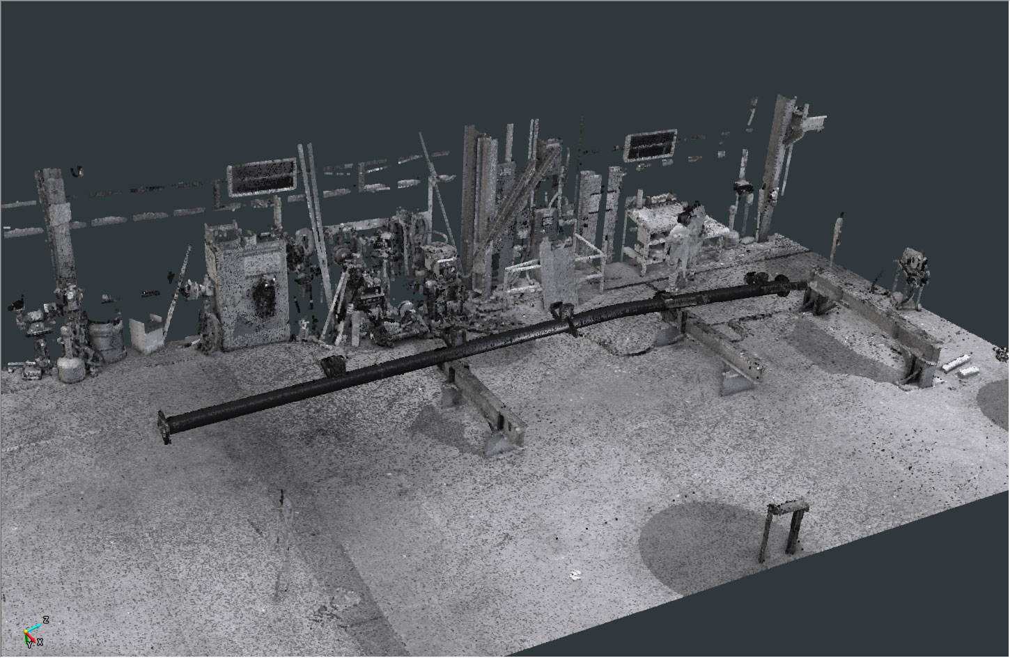

BuildIT Metrology 2021 in “Focus:” Unlock the Power of Large Volume Scanning Spheres BuildIT Metrology 2021 in “Focus:” Unlock the Power of Large Volume Scanning Checkerboard

BuildIT Metrology 2021 in “Focus:” Unlock the Power of Large Volume Scanning Prior to Analysis
