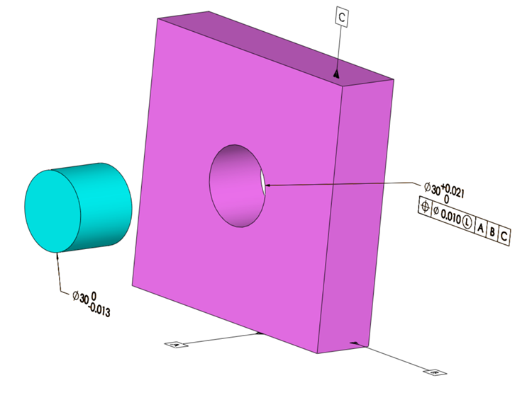

Figure 1. Part with Maximum Material Modifier: As the designed fit is for a looser tolerance fit, the maximum material modifier becomes more appropriate.

MMC: More Clearance, Looser Fit
Design Intent: Easier Assembly (Implied: Less Location Accuracy)
Worst Case Condition for Assembly: Maximum material condition
The design intent of the maximum material modifier being easy and guaranteed assembly, we don’t care if the mating pin wiggles around a bit after assembly. So we encourage the hole to be larger, putting a maximum material limit.
As the hole gets larger in size (hence moving from maximum material condition toward least material condition), it provides a looser fit with the mating pin. The clearance gained can be used as a bonus tolerance for position tolerance.

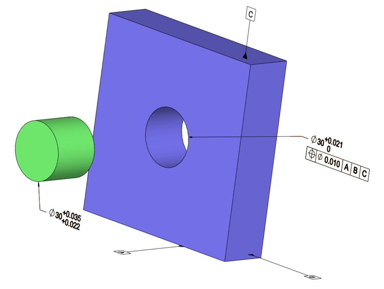

Figure 2. Part with Least Material Modifier: As the designed fit gets tighter (Pin tolerance decreased with respect to the one in Figure 1), the least material modifier becomes more appropriate.
Design Intent: More Location Accuracy (Implied: Less Easy Assembly)
Worst Case Condition for Location Accuracy: Least material condition
The design intent of the least material modifier being more location accuracy, we don’t want the mating pin to wiggle around so much after assembly. So we encourage the hole to be smaller, putting a least material condition.
As the hole gets smaller in size, it provides a tighter fit with the mating pin. The tightness gained can be used as a bonus tolerance for position tolerance.
The use of LMC can pose some risk in the assembly, as it is difficult to design and manufacture the correct tightness limit for the assembly (as opposed to looseness limit in the MMC case). If the hole gets too small, we can end up getting an unwanted interference fit.
