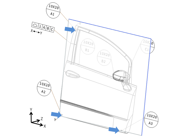

3 Datum Target Areas on the Primary Datum Plane
Select 3 positions for datum targets on the largest surface of the part, positioning them as far apart as possible for stability (Figure 1). Since we have a very large surface, the use of datum target areas instead of points for simulated datums is more precise. In our case, these datum target areas are designated by A1, A2 and A3.
Primary datum plane
Figure 1. Primary datum plane defined by three datum target areas (A1, A2, A3)
With these three datum target areas, we have eliminated translation in the Z-axis and rotation around the X-axis (roll) and Y-axis (yaw).

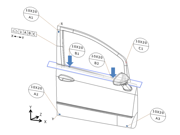

2 Datum Target Areas on the Secondary Datum Plane
Select 2 points on the second largest surface of the part, perpendicular to the primary datum plane (Figure 2). Again, we make use of datum target areas instead of points for our simulated datum. These datum target areas are designated by B1 and B2.
Secondary datum plane
Figure 2. Secondary datum plane defined by two datum target areas (B1, B2)
With these two datum target areas, we eliminated translation in the Y-axis and rotation around the Z-axis (pitch).

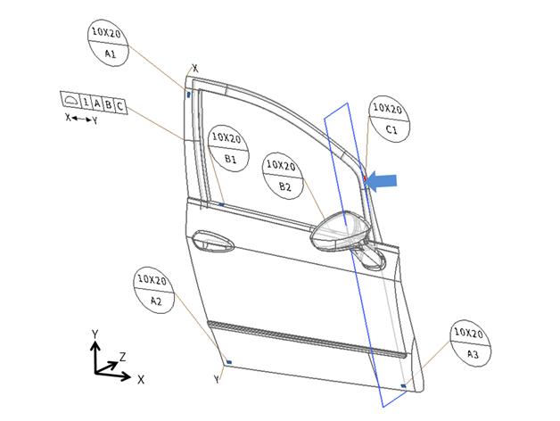

1 Datum Target Area on the Tertiary Datum Plane
Select 1 datum target area on a surface perpendicular to both of the previous datum planes (Figure 3). This datum target area is designated by C1.
Tertiary datum plane
Figure 3. Tertiary datum plane defined by one target area (C1)
With this final datum target area, we eliminated the translation in the X-axis.

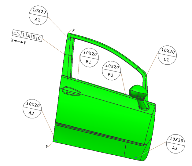

Final Drawing with datum target locations table
Figure 4. Final Drawing with datum target locations table
Lastly, we should define the locations of these datum target areas with respect to a defined coordinate system (Figure 4). Take note that this was just one of the possible datum reference frames we could define. Another interesting and commonplace configuration would be to use more than three datum targets on the primary datum plane. We will delve into this subject in the next blog posts.
