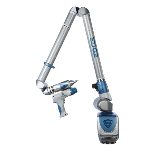

A relatively new solution that aims to combine the ease of use of a gage with the accuracy and data collection of a traditional CMM is the implementation of a portable CMM.
A portable CMM can be set up at a small station near where parts are manufactured. When a part needs to be checked, an operator loads a pre-written program and quickly touches off key points or scans in a part using a laser scanner attachment. The operator then receives instant feedback about whether the part has been made correctly or not.
Additionally, each check is saved for later use. After a specific number of runs or time, a supervisor can easily run a trend analysis of all parts measured to track how the parts are being made. This report can be used to identify feature drift, wear patterns on a die, or to aide in preventative maintenance.
One portable CMM can replace a virtually unlimited number of gages, given that a trained operator creates the programs beforehand, which drastically reduces storage space issues. Portable CMMs are also light and easily transported by an able bodied worker when necessary. To solve bottlenecking issues, multiple portable CMMs can be run by many operators with minimal training in how to use pre-written programs. Finally, startup and maintenance costs are drastically reduced since a company would only need to purchase or re-certify their portable CMMs instead of a large number of individual gages.
