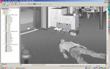

3) Safety: Data can be collected from a distance, with some scanners collected measurements over 300 meters away. This allows the operator to scan a scene out of harms way. In addition, laser scanners can collect up to 1,000,000 points per second with average scan times of several minutes. Less time on a scene means less time for potential danger to the individuals at the scene. Class I lasers are also being used in laser scanners creating a truly eye-safe environment during the scan.
4) Speed and Efficiency: Complete color scans can be captured in as little as several minutes creating a virtual scene with high accuracy and detail that can be revisited over and over without physically traveling to the site. In contrast to traditional methods of surveying/documenting a scene, laser scanning can be much faster and allow multiple investigators to have eyes on the virtual scene.
5) Produce a variety of deliverables: Once the scene has been laser scanned, various types of final products can be extracted or produced from the data. For example, anything from a traditional 2D drawing to a detailed 3D animation can be created from the scan data.

8) Strumenti di misurazione specializzati: il software per l'analisi forense da dati 3D ora include anche strumenti speciali per misurare gli schizzi di sangue e la traiettoria dei proiettili, l'altezza del testimone / sospetto, ecc.
