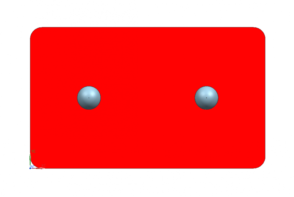

Figure 1. Which pin determines the X position of the workpiece? Impossible to determine.
The use of two pins placed in two holes poses problems in both location and manufacturing (Figure 1):
Problems with assembly
  1. Impossible to determine the exact location of workpieces.
  2. Creation of high stresses in the workpiece as a result of overconstraint in the workpiece location.
Problems with manufacturing
  1. Holes in the workpiece must be machined to very tight diameter and position tolerances, thus increasing the manufacturing cost.

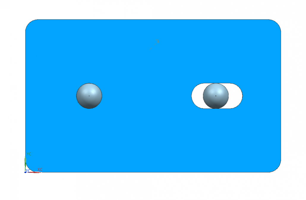

Figure 2. The pin on the left determines the X position of the workpiece.
To overcome these issues, one of the pins can be assembled into a slot. Thus, the pin in the hole removes two translational degrees of freedom, while the one in the slot removes the final rotational degree of freedom.
