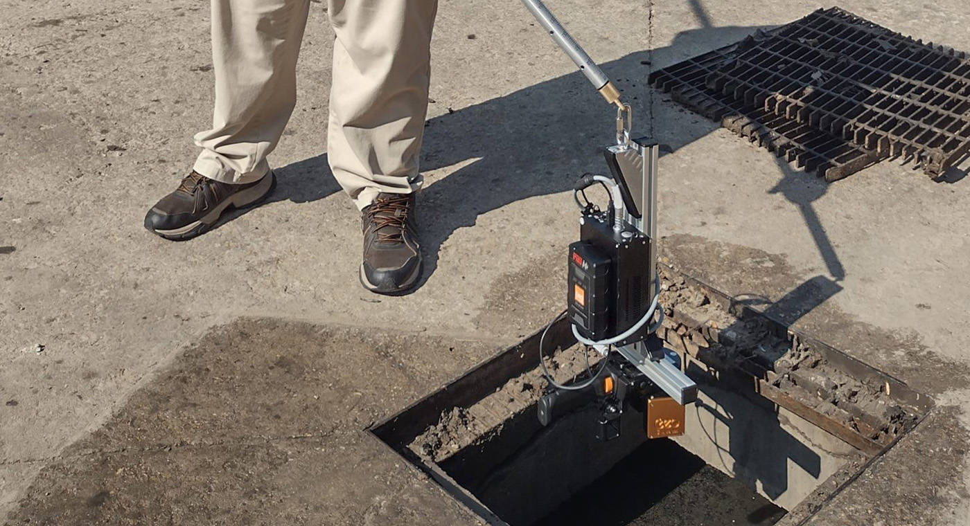

Mobile LiDAR solution on a pole being lowered down a drain

To tackle these issues, the team decided to adopt mobile LiDAR technology to aid them in their projects. The goal was to scan over half of their 2 million sq. ft. of interior space every year.
The Mobile LiDAR solution is handheld, accurate and fast, providing the team with a perfect tool. In addition, simplicity and ease of use mean only one team member needs to travel to a site, when necessary. Data capture with mobile LiDAR led to a faster return on projects, higher levels of accuracy and a high return on investment.
By using mobile laser scanners the Kansas Adjutant General's Department has updated over 1 million sq. ft. of interior space, achieving their overall goal, with just one technician visiting half of the sites per year. The speed of capture means that the average time it takes the team to carry out a scan is just 20 minutes. By collecting accurate measurements, they can now regularly update their GIS database, which provides up-to-date floorplans throughout the state.

Due to the success, they have expanded their use of mobile LiDAR technology by acquiring a ZEB Horizon, which they use in a variety of applications. The range, versatility and data capture points make the ZEB Horizon a great option for large exterior scanning. This is important to the Adjutant Genera's Department as they cover land of up to 50 acres.
