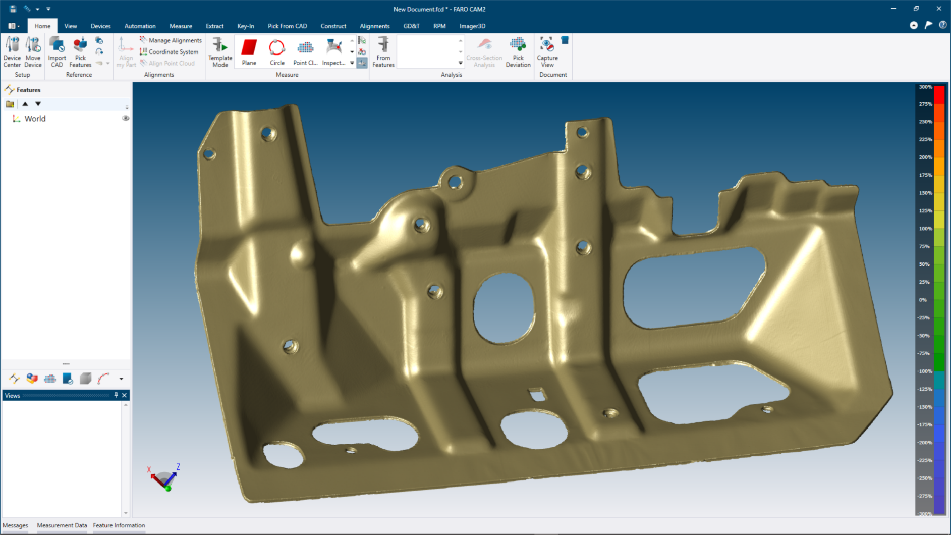

For example, CAM2 2019 provides users with scanning profiles to assist them in selecting the most suitable settings ensuring the correct level of data is captured. Now, when capturing a point cloud, the “Feature Properties” option provides the following scanning profiles:
Full: captures with the full resolution of the Laser Line Probe, the laser scanner attached to the FARO measurement arm.
Fine Detail: for small components which present fine details such as very small, detailed moldings.
Detail: for components where some details are present, such as small pressings with etched or stamped part identification numbers.
Curvature: for molded or pressed parts that have many small curved or radiused surfaces, such as plastic molded or pressed automotive components.
Smooth: for larger parts with flat or large curved surfaces, such as motorbike fuel tanks or car body panels.
To use a scanning profile, the user simply selects the required icon. It is also possible to create custom profiles by double clicking an existing profile and editing the settings.
Preset scanning profiles enable any user to choose the appropriate scan setting for the specific part type with a simple click of a button, thus streamlining the overall measurement experience.
Moreover, with the “Live Deviation Color Scan” functionality, users can quickly check the quality of parts during the scanning process rather than as a post process. CAM2 provides real-time feedback with different colors showing deviations of scan data from CAD models as the operators are scanning, allowing live identification of potential issues.
An additional feature that facilitate users’ activities is the “Align-My-Part Wizard”, which simplifies CAD-to-Part alignment. With a single button click, the operator is guided through the process of defining an alignment using 3 features or 6 or more surface points.

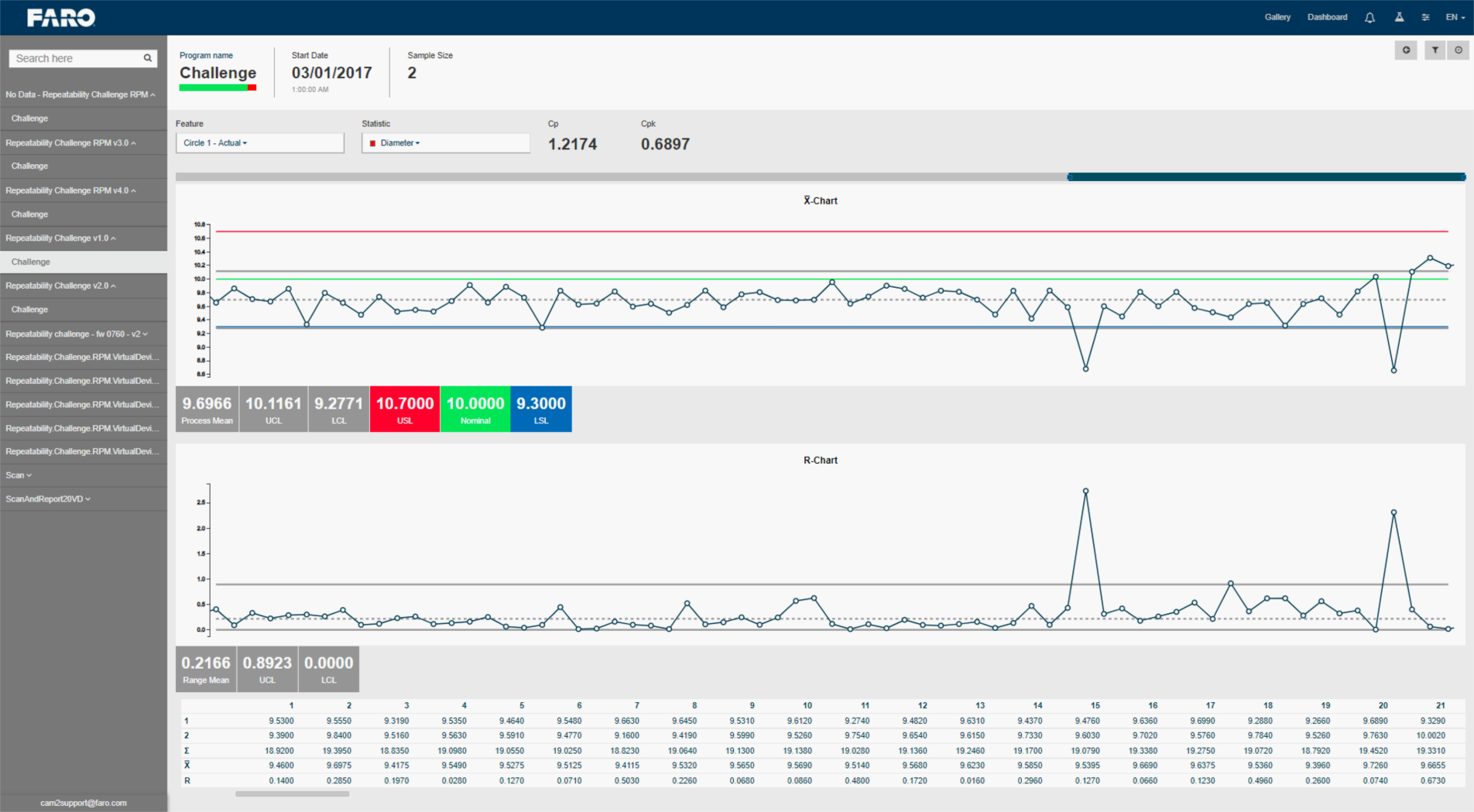

Actionable Intelligence Through Statistical Process Control (SPC)
CAM2 has been designed to allow any user to step through even the more complex inspection routines. Repeat Part Management (RPM) provides an ecosystem where part programs from CAM2 2019 can be uploaded and run within the RPM Control Station, a fully-guided inspection software that can be executed by anyone, anywhere across a factory floor. That means that a specific inspection process can be designed once and then repeated and easily executed by anyone on the factory floor.
ReportThe CAM2 2019 Software platform also supports an effective and smooth “interconnection” between metrology measurements (quality assurance) and production. It features the RPM Control Center, an integrated, web-based dashboard reporting tool that delivers real time inspection results and insightful trend analysis in a user-friendly set of adaptable visual reports.
This addresses the increasing needs for SPC (Statistical Process Control), delivering actionable manufacturing insights that go beyond simple component quality, with statistically based graphs and results for trend analysis and predictive alerts. These alerts not only highlight that the measurement target is trending beyond tolerances, but also provide advanced intelligence into the process and why a specific situation is occurring. This helps companies improve their processes and predictively anticipate when and why components may drift out of specification.
