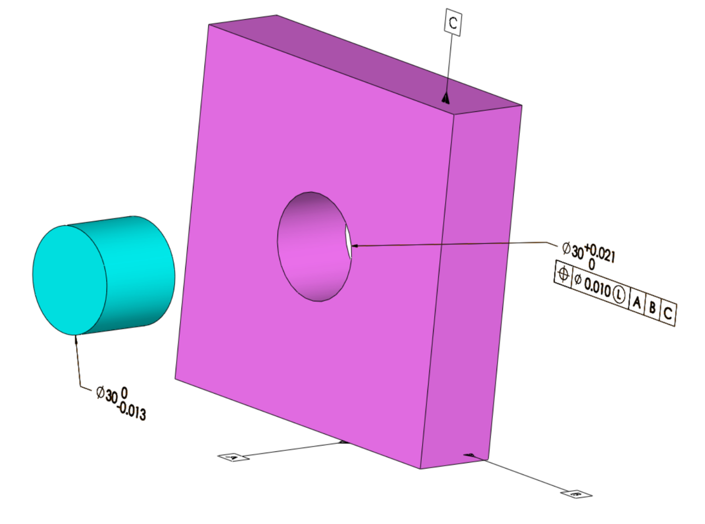

Figure 1. Part with Maximum Material Modifier: As the designed fit is for a looser tolerance fit, the maximum material modifier becomes more appropriate.
The use of material modifiers in GD&T may seem quite abstract for beginners. When should we use MMC (Maximum Material Condition), LMC (Least Material Condition) and RFS (Regardless of Feature Size)? What are the practical implications of these modifiers? This text emphasizes the relationship between material modifiers and fit conditions. Take note that this is just a conceptual introduction and that each application should be considered in its particular circumstances.

MMC: More Clearance, Looser Fit
Design Intent: Easier Assembly (Implied: Less Location Accuracy)
Worst Case Condition for Assembly: Maximum material condition
The design intent of the maximum material modifier being easy and guaranteed assembly, we don’t care if the mating pin wiggles around a bit after assembly. So we encourage the hole to be larger, putting a maximum material limit.
As the hole gets larger in size (hence moving from maximum material condition toward least material condition), it provides a looser fit with the mating pin. The clearance gained can be used as a bonus tolerance for position tolerance.
