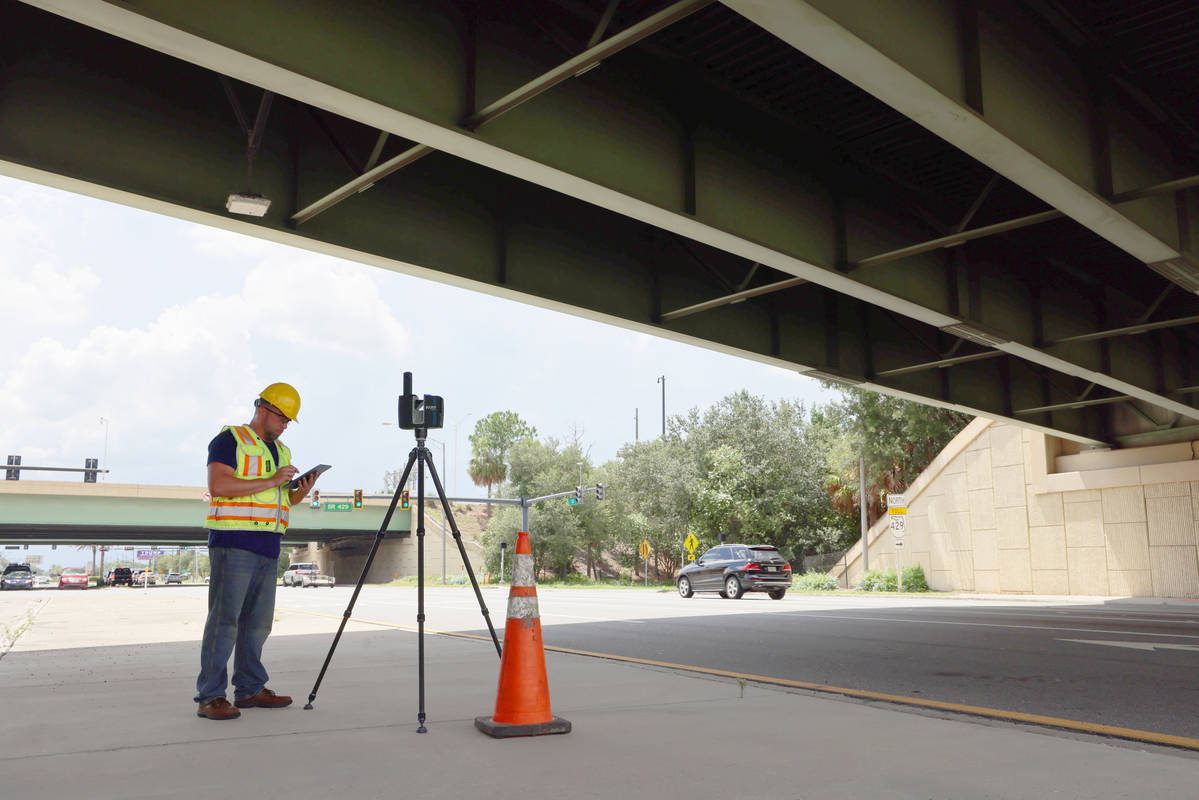

    FARO® Focus — Terrestrial Laser Scanning
    Focus represents the pinnacle of precision. The tripod-mounted 3D laser scanner captures millions of data points from a fixed position, generating ultra-dense point clouds with millimeter accuracy. This level of detail makes the LiDAR solution indispensable for environments where accuracy cannot be compromised, like detailed scans for BIM workflows or high-stakes industrial projects.
    A man stood under a bridge in personal protection clothing with a tripod based terrestrial laser scanner

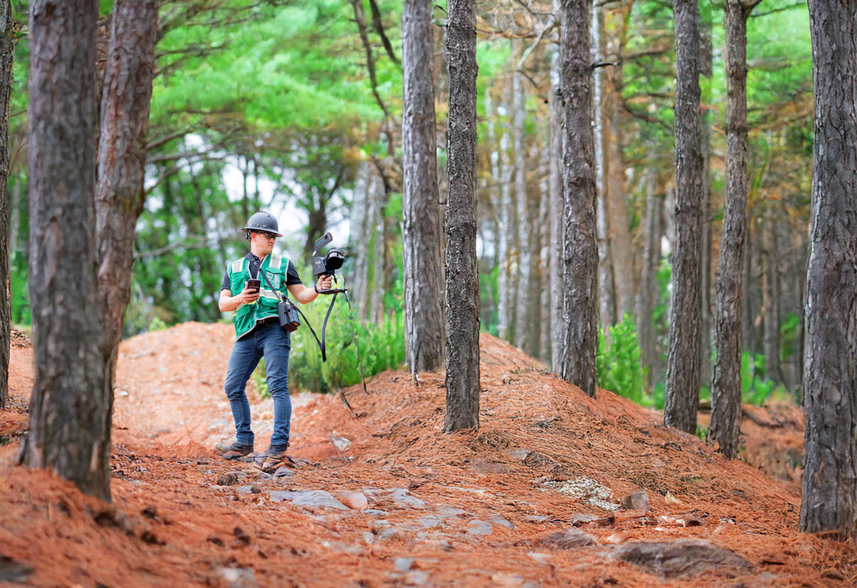

    FARO® Orbis™ Premium — Mobile Laser Scanning
    Orbis Premium is known for its speed, versatility, and high-quality output. By merging LiDAR technology with 360o images, Orbis provides exceptional data and visuals in one compact, handheld device. Moreover, this scanner can be mounted on a backpack for navigating rugged terrains like forests or attached to a vehicle mount to cover larger areas efficiently and quickly.
    A man mobile mapping a forest in personal protective clothing, using a FARO Orbis Premium

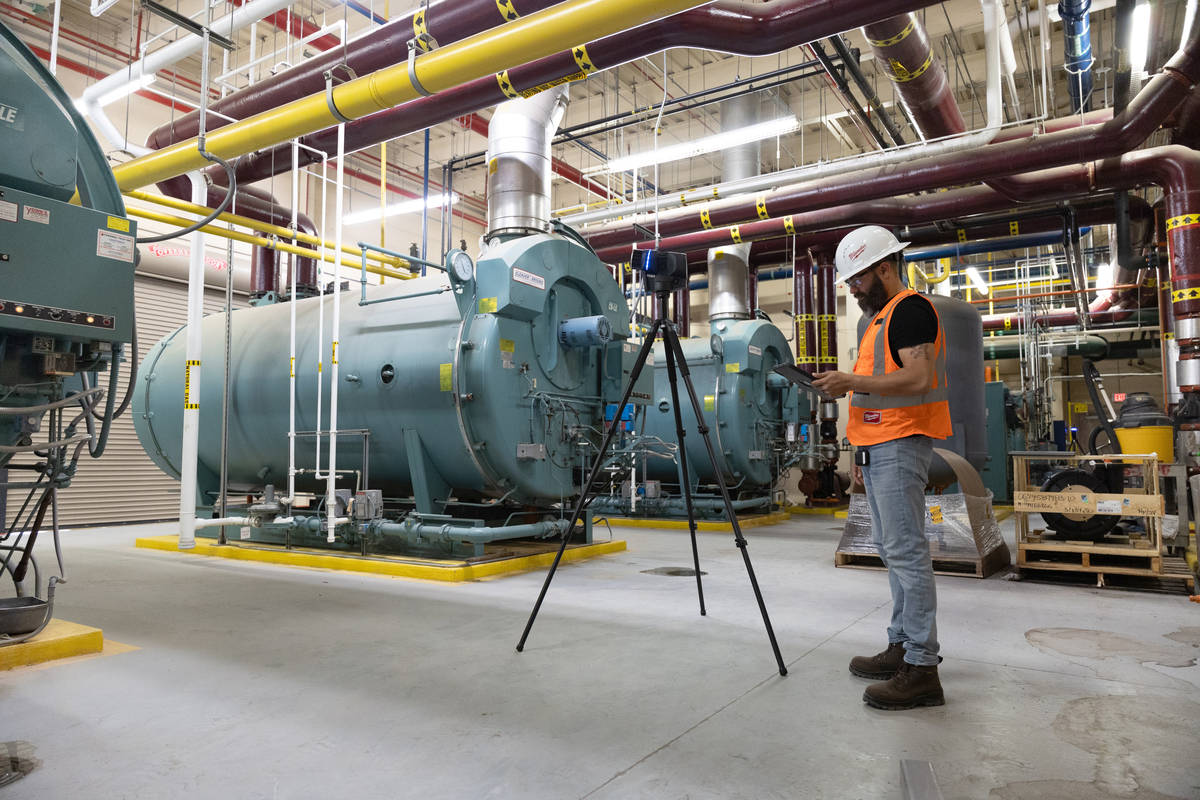

    FARO® Blink™ — Imaging Laser Scanning
    Blink simplifies and speeds up reality capture. This sleek tripod-based system combines rich 360o images with point cloud data. Its user-friendly design, guided scanning, and automatic insights through FARO Sphere XG make it the ideal solution for professionals seeking quick data collection, quality visuals, and effortless setup.
     A man mapping a boiler room using a FARO Blink imaging laser scanner in personal protection clothing
