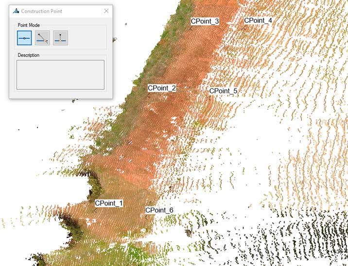

Topo Surface command in PointSense facilitates building of Revit site plans from scan data
Figure 1. The Topo Surface command in PointSense facilitates the building of Revit site plans from scan data.

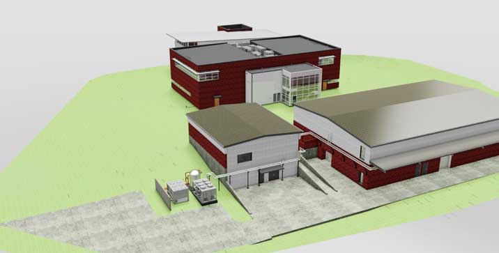

Accurate models built from laser scans
Figure 2. Accurate models built from laser scans allow customers to visualize the finished project.

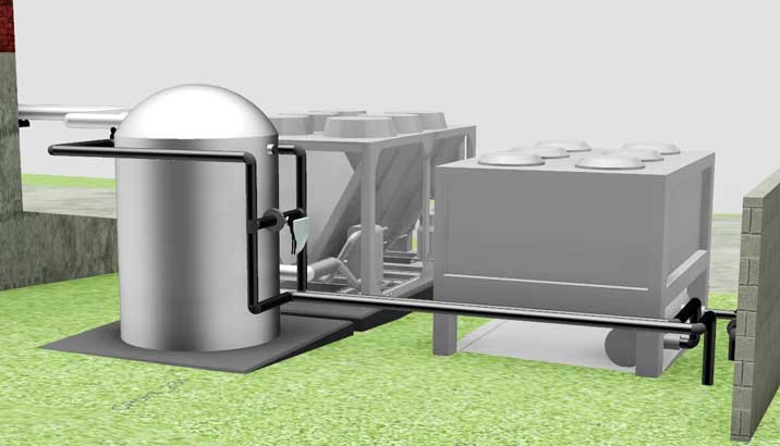

equipment modeling
Figure 3. Existing equipment was modeled from the scans, and new equipment is added with piping and valves.

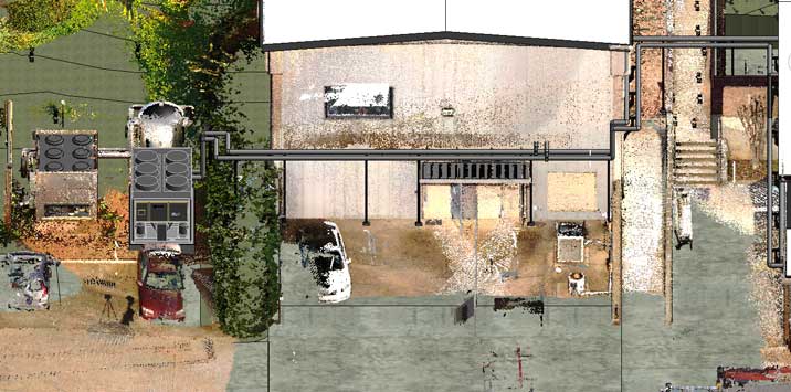

laser scan on piping and conduit routes
Figure 4. From one laser scan, all dimensions are available to plan out piping and conduit routes.

Roebuck used the PointSense software to create the topography for the Revit® Site Plan. He then moves the point cloud to match elevations if he didn’t scan with the GPS on. Once the elevation is correct, other levels such as tops of walls, slab heights, and roofs are set, and he then rotates the cloud to the “Project North” that he wants to draw in. After enough PointSense Construction Points are created to suit the project, he lets PointSense build the topography with its Topo Surface command.

One of the biggest challenges of the project was the routing of chilled water lines from where the new chiller was located to the new chilled water air handlers, which were located just a few hundred feet away.

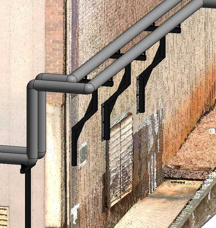

wall mounted piping support
Figure 5. Keeping a clear walk path required designing wall mounted piping supports.

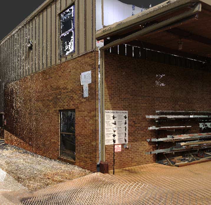

Roebuck’s initial discussions with his customer had the piping going through the plenums of both buildings to be served by the chiller. However, once the site was scanned and the plenum spaces were assessed, they realized that the piping would have to run externally to the building. The biggest problem being that there were I-beams and ducts that would have made the pipe runs both difficult and expensive.
The external piping would have to cross a walkway between the two buildings and would need to be at an elevation with plenty of head clearance. The customer also didn’t want the field constructed strut type bracket on the side of the building.
Using the point cloud to measure and model the building, Roebuck and his team designed a pipe support system that they could have a machine shop build and powder coat.
“By using the FARO FocusM 70 Laser Scanner, we were able to design the piping supports for construction by a machine shop and be shipped to the site,” Roebuck says. “We were able to accurately route the piping and derive the total equivalent length for chilled water pump sizing, and we were able to erase equipment that’s being replaced from the point cloud and fit new Revit equipment into the voids to check clearances.”
Not only did the laser scanner help provide the necessary steps to get the piping supports built, but it also cut down the time needed to complete the project. “The data acquired through the use of the laser scanner improved our modeling accuracy and efficiency and saved weeks of labor in field measuring time. All of the scanning necessary to model the project took about 20 hours” he says.

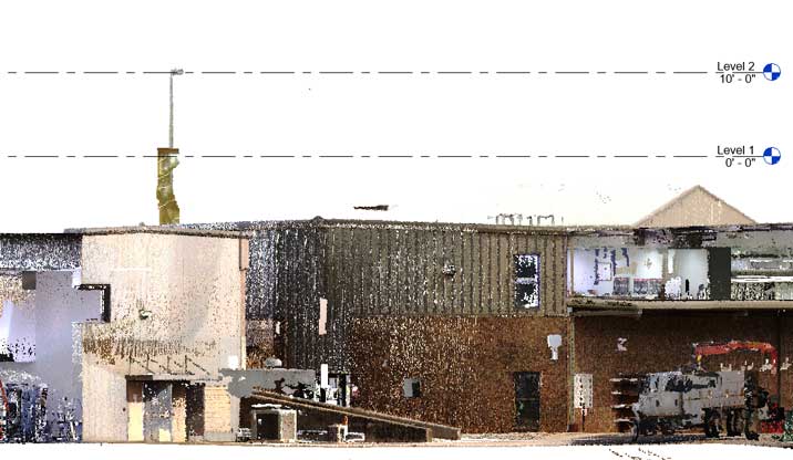

level adjustments for ease of modeling
Figure 6. The scans come into Revit needing alignment and level adjustments for ease of modeling.

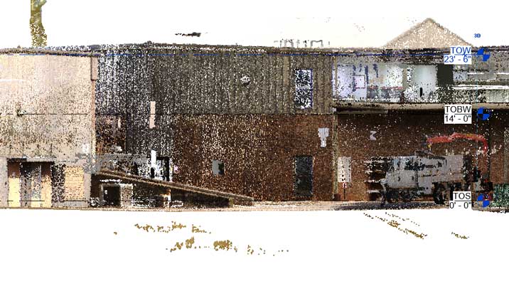

aligned building slab
Figure 7. The building slab is aligned to the 0’ 0” level so that spot elevation references are accurate in the drawing set.
