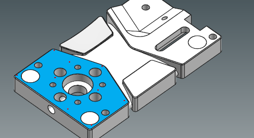

Using our ModelX taken from our example models (Accessible through File: Example Models: ModelX), let’s use the Surface Inspection Annotation to evaluate points taken on the surface highlighted in light blue. This command is accessible through Evaluate: Annotations: Surface Inspection Annotation.

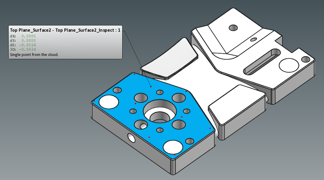

Below, I have set a surface inspection annotation on a single point taken from a cloud that was generated while inspecting the blue surface. I have chosen the option to Show Full Annotation in order to display the deviations along each axis, as well as the absolute deviation and a custom inspection note.
Surface inspection
Surface inspection
Since the current coordinate system is square with the plane, the dX and dY deviations are zero and the absolute deviation is equal to the Z deviation. Therefore, we will not be using any superfluous information in the annotations for the rest of this example.

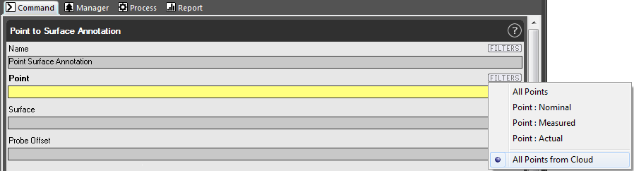

This method of annotating the surface can be used multiple times to annotate every point in the cloud – in this example, we do not have a lot of measurements. Using the filters, it is also possible to select All Points from Cloud at once, making the annotation process much faster.
All points from Cloud in command

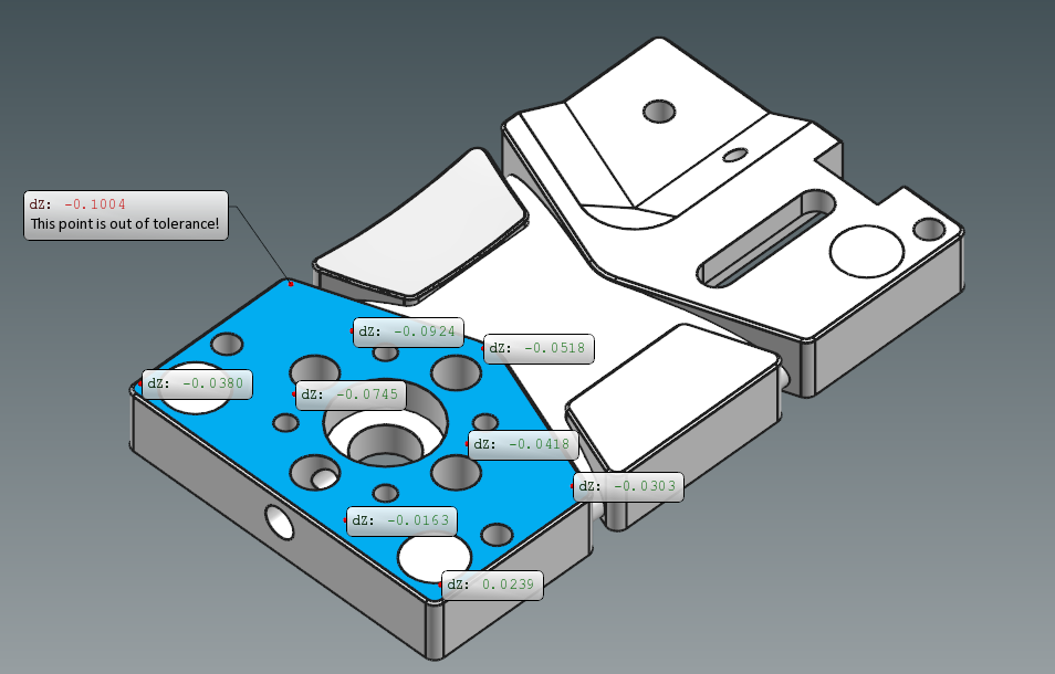

Once all points have been annotated, it is still possible to edit any of them manually afterwards to annotate them individually.
ISO All points and 1 custom
