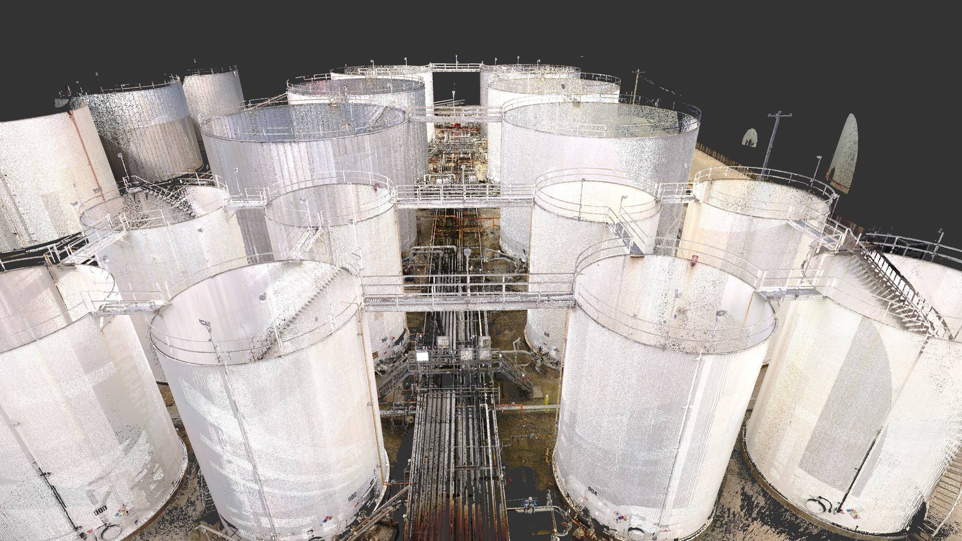

Now this cumbersome process has evolved in the form of 3D laser scanning and its related software applications. Last summer, UK-based digital twin surveying specialist, Advanced 3D Laser Solutions Group (A3D), in concert with their US partner HTS Advanced Solutions, 3D laser scanned a large liquid storage terminal in Houston, Texas specifically with the goal to generate more accurate and more precise 2D P&IDs from 3D scan data. To successfully achieve this task, the companies relied on two FARO® Focus Laser Scanners and FARO SCENE Software.
“The Focus Laser Scanner was chosen because of its data capturing speed, portability, which was key for scanning in tight spaces, its ruggedness in different areas of site and consistent clear images which would be key for our CAD team in developing P&IDs,” explained Lewis Boxer, A3D’s Technical Director. “The scan data was processed in SCENE because of its obvious compatibility with the Focus scanners and its variety of built-in clean up filters such as edge, range and stray point. SCENE is also fully equipped with a range of registering tools including target-based, natural targeting and cloud-to-cloud, which, when working on a site with a range of variables, you need software that’s adaptable to different challenges.”

After each shift the scans were uploaded via SFTP directly to the A3D server allowing for the UK-based team to complete scan file registration, including the filtering and processing of the data. This process ensured they could report on any missing data to the survey team ahead of the next scan shift. The survey was completed in 3 months during the Texas wet season with a total of 5,136 scans recorded. Instead of taking the 2-3 years to wrap up using traditional surveying techniques, A3D completed the entire project from start of site scanning to delivery of Smart P&IDs in just 10 months.
To work as efficiently as possible, A3D planned the individual aspects of the job to run concurrently wherever possible. For instance, once an individual area was scanned and registered, they were converted immediately, ready for the CAD team to start building the P&IDs before returning to HTS for field validation and client team for remote E&I updates. It was only then that they were handed over to Vopak in their as-built perfect form. The entire process was streamlined so that scanning was prioritised to align with the order in which P&IDs were to be delivered, starting within days of the first recorded data. Running a project that amounted to over 650 P&IDs required detailed tracking which A3D achieved internally using specialist project planning personnel and software. The results were shared with key client stakeholders during weekly progress meetings.
For each area, a drawing template was built which significantly sped up the process of building the subsequent P&IDs for that area and maintained a user-friendly, consistent standard throughout. The laser survey provided ample detail for A3D to create everything except remotely connected instrumentation, which would be added from Vopak’s existing P&IDs, DCS panels or existing wiring diagrams.
