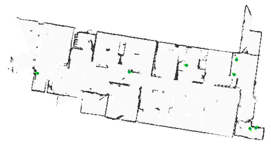

When a user walks through a building using ScanPlan, the emitted laser records the location of everything it hits at a rate of 29,000 points per second with a 230° field of view. Simply walk through the building at normal speed and point the ScanPlan at the walls. The floor plan is displayed in real-time on a smartphone (Android or iPhone) attached to the device. This allows the user to verify that all walls have been mapped successfully before leaving the site.
Banks Fire Department Banks on FARO to Keep Oregon City Safe
View of the floor plan map as it is captured by ScanPlan
For distances less than 3 m (9.8’), the map is dimensionally accurate to +/- 3 cm (1.2”). When the map is brought into FARO Zone software, length and area measurements can be quickly obtained.

Laser-scanned map from ScanPlan
