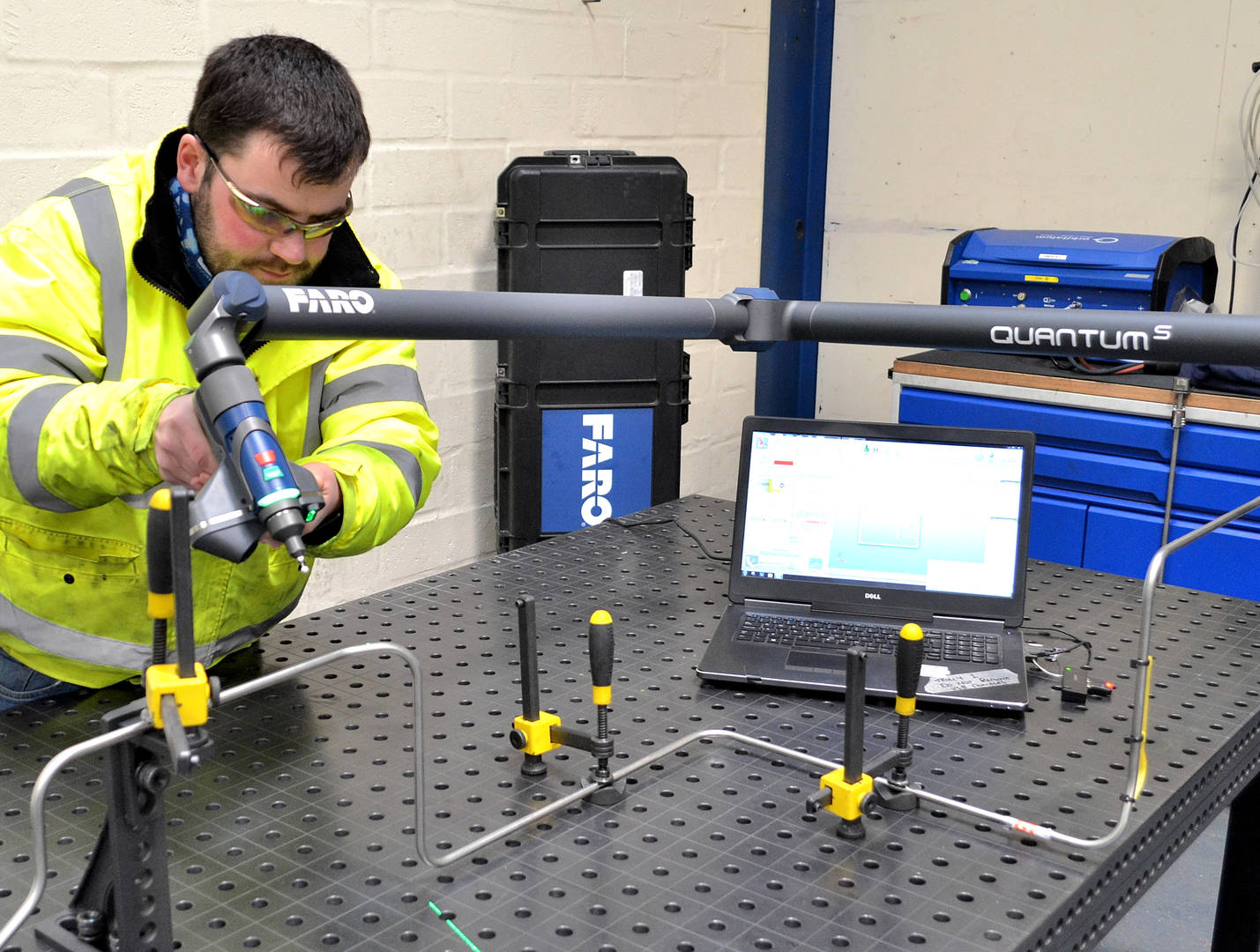

Although L&N Scotland’s new QuantumS ScanArms have delivered significant benefits to several company departments, it is in the area of subsea control system manufacturing that they have provided the biggest advantages. L&N Scotland QC Inspector Adrian Chalmers added, “We produce complex, pre-manufactured, subsea control system kits that feature a huge number of very long pipes. The turnkey kits’ pipes feature intricate compound 3D shapes with challenging dimensional tolerances. Further complication things, the pipes are located in close proximity to each other.
“High-precision inspection is vital as our kits are dispatched across the globe, and on arrival, the various pipes are expected to connect and assemble without the need for re-work or adjustment. As some of our pipes are over 10ft in length, the smallest angular error at one end of a long pipe has the potential to cause an inaccuracy that can be measured in inches at the opposite end, allowing it to foul a neighbouring pipe. Therefore, to guarantee ease of assembly and to make sure that no pipe-to-pipe contact occurs, part of my duties are to ensure that all of our pipes are efficiently and precisely manufactured and also carefully inspected.
“As it was the ideal combination for our requirements, we specified our three new FARO ScanArms fitted with FARO Prizm Laser Probes. Since we have been using our new FARO hardware and software we have made excellent progress in the area of subsea control system pipe manufacturing and inspection.
“As the pipes in our kits can spring and flex under physical inspection, the extremely accurate non-contact scanning capabilities of our new QuantumS ScanArms have provided us with a major advantage. We can now precisely scan the most complex shaped tubes and compare our findings to their CAD models, then if needed, we are able to instantly send any required bending correction information back to our CNC bending machine. Also, when required we can now reverse engineer existing pipes and create precise models for future use.
“In addition to ensuring the premium quality of our pipes, our new FARO hardware and software has vastly improved our efficiency levels and has helped to reduce our subsea control system manufacturing lead times.”
