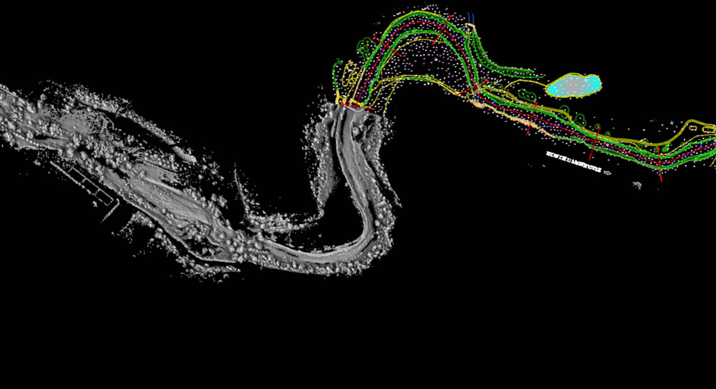

In 2021, the company was tasked with completing a survey of a villa on a steep hillside, in Théoule-Sur-Mer. The goal of the project was to create a detailed topographical map of the existing building and surrounding area, working closely with an architect who will use the map to plan and conduct new construction work. As the surveying experts, they establish whether the site is suitable for the planned construction work, and the architect uses the 3D/2D vector to put together plans for the construction work.
The ZEB Horizon was chosen to conduct this scan because of its speed of acquisition, precise measurements, range, and versatility. A large part of the scan took place on a steep hill leading up to the house, so a mobile scanner was the ideal choice.
The surveyor in charge of this scan, Robin Bruna, was able to walk and scan, cutting down the time it took to capture the entire area. Due to the tough terrain, the entire scan was conducted using only the ZEB Horizon.
The area of land scanned, including the house, totaled 8000 sq/m and was captured in just 4 scans. Each scan took approximately 10-15 minutes to complete, so the team was able to capture usable point cloud data in approximately one hour.
Processing and Analyzing the Results
The separate scans were then processed and merged into a complete 3D point cloud before being georeferenced. The team then took the point cloud through a classification process to better understand the land before creating a 3D/2D vector map in Autocad.
They also created longitudinal cuts in the cloud to provide the architect with reliable and visual information about the incline of the hill. The maps created will help the architects carry out landscape insertions and plan out new construction work for the lower part of the property.
