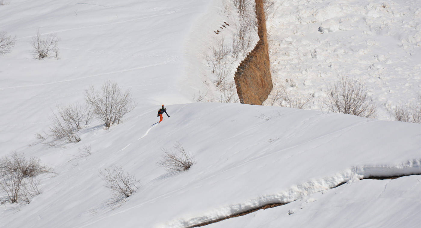

To collect data from the snowpacks and avalanches, the team needed an accurate 3D model of the area. Vanoise National Park is a no-fly zone which meant that UAVs were not an option. Additionally, the team did not want to spend extended periods on the mountain due to the risk of avalanches. This ruled out more time-consuming methods of surveying.
As a result, the team needed an efficient way of mapping the difficult area. They decided mobile LiDAR was the best option and chose to use a ZEB Horizon mounted to a backpack.
Point cloud data of a mountain range highlighting key areas
Using the ZEB Horizon to Safely Map Avalanches in the Vanoise Massif Mountain Range
The walk and scan method and versatility of mobile LiDAR stood out to the team from IPGP. The specificity of the environment meant they needed to use technology that was easily movable and durable. The backpack solution was essential because it meant that the person carrying out the scan had their hands free to help navigate the tough terrain.
The use of mobile LiDAR meant the team was able to scan the 3000 sq/m area in approximately 2 hours. This ensured that they did not spend too long in the hazardous mountain range, whilst capturing the accurate data they needed.
