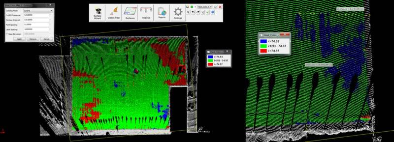

Step 5: Identify high/low areas using the Rithm Builder App in SCENE

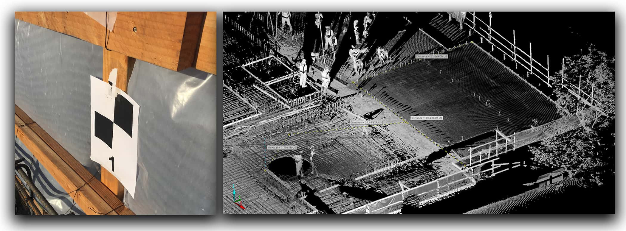

Step 1: Establish elevations – The first step is to establish elevations. This allows one to see the relationship between the actual elevations of the concrete versus the design elevation. A checkerboard target, which can be printed on an 8.5”x11” paper (Figure 2), provides a link between the 3D laser scan data and real-world elevation. For a three minute scan, the checkerboard target with known elevation should be within 60 feet of the scanner. If there is no elevation within 60 feet of the scanner, or the scanner does not have a line of sight on the elevation, a builder’s level can be used to easily and quickly move an elevation to a place ideal for scanning. It is best to pre-plan your possible scan locations and place elevations ahead of time so that one can be seen by each scan location, giving more time to process data in between scans. Place a checkerboard target over the elevations.
Step 2: Scan – Using a FARO Focus3D X 330, select the appropriate resolution which can collect points with 1/4” spacing at 30 feet away. For those familiar with the Focus3D interface, this is a 1/5 resolution and 3x quality scan with no pictures, resulting in a three minute and 17 second scan. Using a standard tripod with the scanner elevated about 6 feet off the ground, you can collect data (Figure 3) up to 70 feet from the scanner that is dense enough to identify high/low areas as well as calculate FF/FL numbers. An elevated tripod can be used to increase the height of the scanner, which will result in capturing usable data at greater distances. The scanner can be accessed remotely by smartphone or tablet if it is elevated beyond reach using the built in Wi-Fi.

Step 5: Identify high/low areas using the Rithm Builder App in SCENE – Open up the 3D View and create a clipping box to isolate just the area of concrete that will be evaluated as shown in Figure 6. Right click the Clipping Box Tool and deselect Visible. Open up the Builder App and click on the Surface Wizard button. It will walk you through how to apply a filter and create a cut/fill heatmap. The filter will get rid of noisy data along with any debris or trash that might be on the concrete as shown in Figure 7.
One can then create quick down-and-out measurements from an easily identifiable point for the finishers to locate the high and low areas so they can fix the concrete while still being wet. This enables the user to disregard the XY orientation of the scan data, all that is needed is one Z elevation as shown in Figure 8-9. The entire process of importing the data and using the Rithm Builder App takes approximately 5 minutes.
