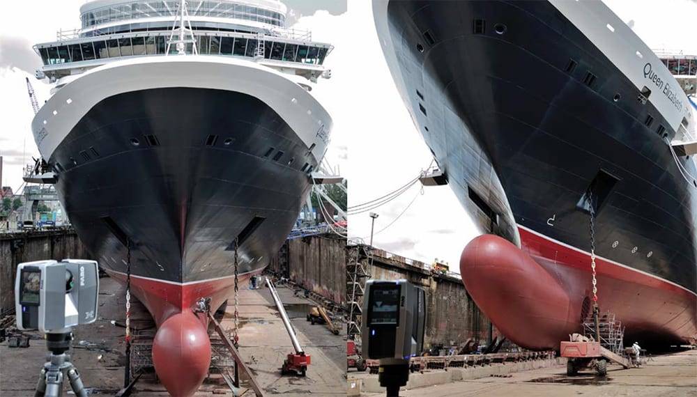

Following her launch in October 2010, in spring 2014 it was time for a general overhaul at the Blohm + Voss dry dock in Hamburg. The comprehensive cleaning and modernization programming had to be completed within the space of just two weeks. In addition, accurate measurements of the ship’s hull were scheduled to be taken during this time. Data obtained during this process was used to calculate the optimization of the hull. The goal was to develop new flow flaps and stabilizers and so to improve energy efficiency. In order to keep to the strict schedule and deliver the required accuracy, the contractor in question, SCAN3D Dienstleistungsgesellschaft, recorded the hull using a FARO Focus Laser Scanner.

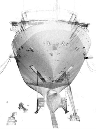

With the Focus, he was able to record the ship’s entire hull in two eight-hour scan processes comprising around 100 individual scans – both from underneath and at various height levels, given that the draft of this luxury liner alone measures 8 meters. “The Focus is ideally suited for working in confined spaces, such as those beneath the keel. It did not take much effort or time to set up, and we did not get in the way of other work taking place around us“. The laser scanner’s high measuring accuracy is incredibly important for the next steps in the process. With a standard deviation of 2.5mm on a ship 300 meters long and range noise in fractions of a millimeter, the laser scanner delivers a highly accurate map of the hull. This level of accuracy is vitally important given that it is not unusual to discover deviations of several decimeters from the planned hull design once the ship has been built.

SCAN3D used LupoScan to process the captured data and subsequently produced a reliable surface model of the ship’s hull. Experts at an engineering firm in Finland were able to take this digital model and use it with CFD to analyze flow behavior around the hull. Flow flaps, stabilizers, and a new bulbous bow were then designed to help boost the energy efficiency of the ship’s propulsion.
“Our approach had one particular advantage: the data obtained was transformed directly into the ship’s coordinate system. This method produces significant time and cost benefits for future installations”, Lars Sörensen explained. “And the Focus enabled us to record basic geometric data quickly and reliably”.
