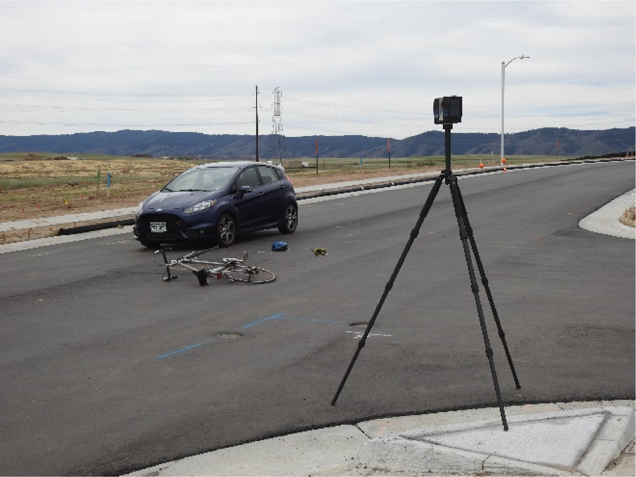

incident-documentation-laser-scanner-vs-conventional-measurement_Fig5
Fig. 5: FARO FocusS first scan location of evidence.

Total station documentation required a two- person crew; one to run the total station and record data points, and one to occupy the evidence point with a prism. The total station determined 3-dimensional (x,y,z) points for each location measured, and only a single setup was required to document the roadway geometry and collision evidence.
Due to the horizontal curvature of the roadway, the wheel measurements of the roadway geometry required the use of a 200-foot tape and a 30- foot tape to determine the radius of the main east-west roadway into the scene (chord and mid-ordinate). Wheel documentation utilized the baseline method by establishing the intersecting curb-lines at the northwest corner of the intersection as the north/south and east/west reference point. Each point was measured within the horizontal plane (x,y), but without any vertical measurement due to the capability of the digital wheel. However, grades of the roadway were taken at regular intervals using a smart level, but not with the intention of recreating a 3-dimensional scene from the wheel data given the time constraint objectives.

The table of Fig. 8 provides the at-scene time to complete each of the measurement techniques for the scenario. The total station survey gathered 68 survey points within 14 minutes but required 4-times greater setup and twice greater tear down times as the HDS scan using the FARO FocusS 350. The three HDS scans required slightly more than twice the amount of time to complete as the total station survey, but gathered nearly 650,000-times more (x,y,z) data points. The maximum allowable relative positional precision for a land survey using the total station is 2 cm + 50 ppm between two surveyed corners, or 0.787 inches.1 The registration report for the three HDS scans using the FARO FocusS 350 indicates a maximum point error less than 13% the acceptable error of a total station survey, with the mean error approximately 8.5% of the acceptable error of a total station survey, as illustrated by Fig. 9. Additionally, the results in Fig. 8 clearly demonstrate that utilizing a digital wheel and 200-foot tape to document the roadway geometry and collision evidence was the least efficient of the three methods presented.

The results contained in Fig. 8 and Fig. 9 demonstrate clear evidence that the FARO FocusS 350 generates vastly more data points in the same relative time as a total station, and at a much higher level of accuracy and precision. The use of a digital wheel and 200-foot tape to record sufficient roadway geometry and evidence for a scaled diagram is not only more time consuming than a total station or FARO FocusS 350, but more susceptible to error due to surface irregularities, the ability of the user to maintain a straight course while measuring, and the skill of the practitioner to make such measurements with perfect perpendicularity to the reference baseline.
