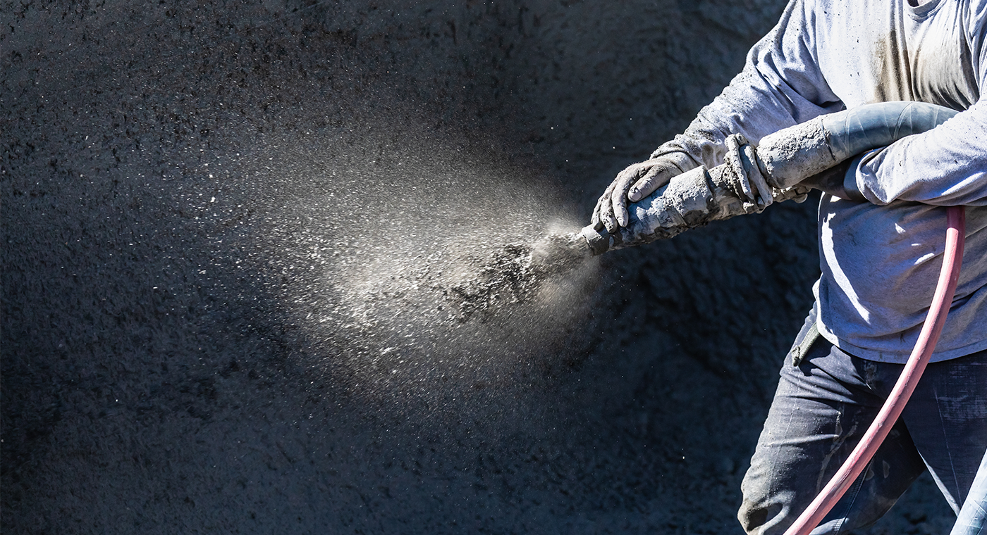

Construction Worker Shooting Concrete, Shotcrete or Gunite Through Hose

Since its conception in the early 1900s, shotcrete application has developed to become one of the most critical ground-supporting techniques for underground excavations. The technology has evolved from manual nozzle handling to computer-guided, hydraulically controlled boom-mounted nozzles. By controlling variables in the shotcreting application, the layer of sprayed concrete can be optimally designed to meet the in-situ geotechnical constraints. In some scenarios, shotcrete will be designed to flex with the squeezing rock, while in others, it may act as a barrier to protect from rock bursts.
Understanding how the shotcrete will react in different conditions allows operators to apply the right material. Shotcrete thickness is paramount when applying shotcrete, therefore it must be monitored during application using the safest and most reliable method. This article aims to demonstrate how the SR-50 system, developed by GeoSLAM, is suitable for near real-time shotcrete application quality assurance and quality control (QA/QC).
