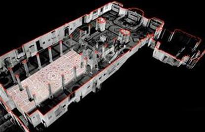

Arte Sacra Inside Scan+
The “Sessa Aurunca 3D Project” has several goals and is broken down into seven specific points that will explore new frontiers within the world of communications: the publication of academic and scientific reports and articles; the organisation of conventions, seminars and events; the production of stereoscopic 3D animations and videos, with the creation of a You- Tube channel and dedicated videos; the creation of a “360-degree Virtual Tour” with a database and “multidata” to “explore” the Cathedral using computers and mobile devices; the creation of thematic apps and a website; and the production of a “docu-film” about the project and the technologies used. Regarding this last aspect, Danilo Prosperi observed: “Part of the success of this initiative can be attributed to the FARO Focus3D Laser Scanner, an extremely precise device that we used to scan the Cathedral’s architecture, which provided us with a point cloud or, more precisely, digital data that we were able to use in our various activities.” The data acquisition phase involved 38 scans made inside and outside the church, including the crypt, and took just over half a day. “The quality of the FARO Focus3D Laser Scanner enabled us to acquire extremely high-resolution and high-precision images with very low margins of error, which was fundamental for the scanning of extremely beautiful details, such as the mosaic floor, the ambo, the spiral Paschal candelabrum and the crypt on the lower level.”
The data gathered were then processed in SCENE, the FARO software for the management of scanned data, designed specifically for the Focus3D. This software was used to create and edit videos and images for the 3D Virtual Tours of the Cathedral. “SCENE,” Danilo Prosperi specified, “allows us to easily process the scanned data and quickly generate particularly complex high-resolution equirectangular panoramic images”. Danilo Prosperi stressed: “We believe that the FARO Focus3D Laser Scanner is the best technology on the market, not only due to its extreme precision, but also because it is so flexible, fast and easy to use. In fact, it is a compact instrument that is very lightweight and easy to move from one scanning position to another.” He concluded: “The collaboration between FARO and the Master’s in Architecture, Sacred Art and Liturgy at the European University of Rome has only just begun. Given the quality of the results, we plan to use the FARO Focus3D Laser Scanner in the future for other projects aimed at promoting highly important monumental sites of great beauty.”
