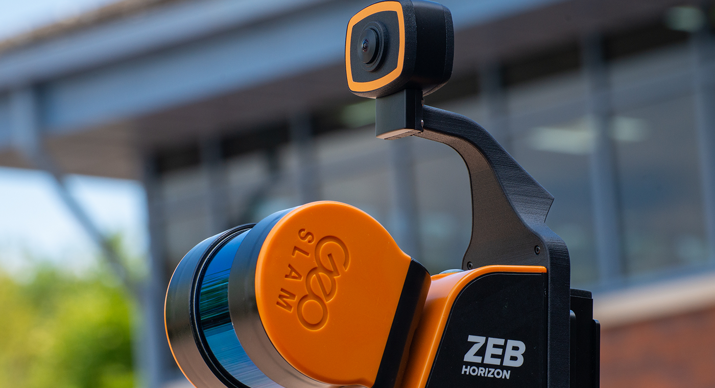

Mobile LiDAR scanner and 360-degree panoramic camera on a wall in front of Nyhavn in Denmark

The most accurate way of colorizing a point cloud is to merge images and data together. Perhaps the most reliable way currently available is to use a camera attachment with a LiDAR scanner. This allows for the capture of photograph and LiDAR data simultaneously. Combining the photos with the data creates an incredibly detailed 3D model. The camera and the laser sensor work at the same time, so they have identical timestamps. An RGB value is assigned to a point based on timing or distance from the point when captured.
