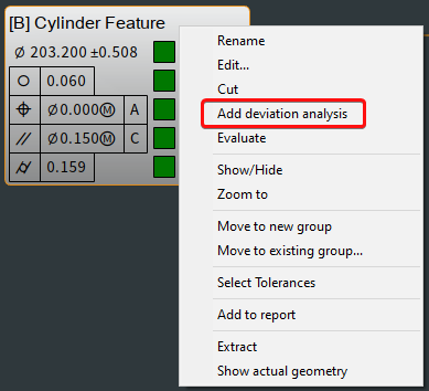

Deviation analyses can be performed in a single click via any feature’s right-click menu.

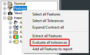

Tolerances can be evaluated directly from the “Features” group.
Show/Hide shortcut has been added to the right-click menus of objects.
