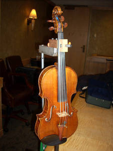

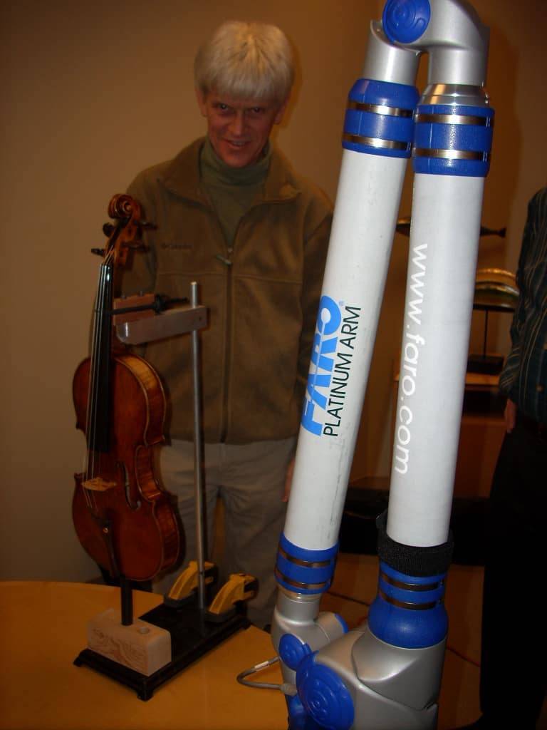

So how do you do it? Laser scan it of course with a Portable Coordinate Measuring Machine (PCMM) with a Laser Line Probe (LLP) attached to it. This way you can get a point cloud of the exterior shape good to about .003” without having to touch the instrument at all. The total time it took to scan the violins was about 45 minutes each. Most of that time was spent inspecting the cloud of points for holes in the data and then going back to fill them in. The actual time scanning the majority of the outside was about 10 to 15 minutes. A small bit of time was also taken to delete extra data collected from the jig the violins sat on. The LLP is a line of sight instrument, so anything scanned with the laser will be picked up by the cameras and added to the cloud of points. Once we were satisfied with the data, it was saved to a file.
FARO Platinum ArmThat takes care of the outside data collection, but just as important for future construction, is what this violin looks like on the inside. Cutting it open is obviously not an option, and neither is virtually anything else. Thankfully downtown at the local hospital is an MRI that can give point cloud data back much like the LLP does on the outside. The stated accuracy is not as good as the LLP, but for this application it was more than adequate. The violins were sat on a soft cushion on top of the table normally used for humans, and in it went. About 10 minutes later the MRI had totally mapped what the inside of the violin looked like. This data was also exported to a file for future use.
