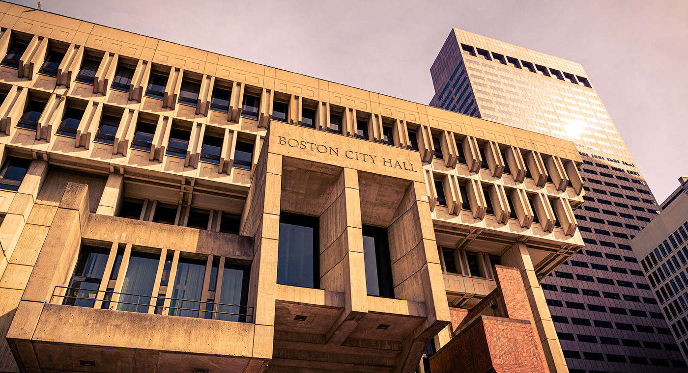

Stock image of Boston City Hall in the daytime
Built-in 1968, Boston City Hall helped boost the city's economy after years of stagnation. The building and surrounding plaza sought to modernize the city's urban core, reinvigorating the run-down neighborhood of Scollay Square.
Despite the welcomed response from the public investment project by the people of Boston, the brutalist style of architecture (popularized in the UK, featuring rough surfaces, massive forms, and unusual shapes) created debate among locals. Despite the concerns from the public, the city hall has been home to the mayor of Boston and the city council for over 5 decades, and the brutal style of architecture has become part of Boston's rich history.
